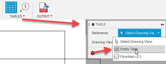

I thought in an earlier version of Fusion there was the ability to add an empty table where I was able to manually add print revisions; however, now I am only seeing an option to add an auto-populated BOM table, even for a single part.
Is there an option to add a revision table with manual entries?

You can add a empty table and fill it in manually with information of your choosing but that is it.  Revision tables may be on the drawing roadmap for development, I cannot say.

I had thought that an empty table was possible in a prior version of Fusion, but I can not seem to find the proper way to do this with the latest revision; when I click on the 'TABLES' table, the only option I can see is for a Bill of Material table this is auto populated and not changeable.
