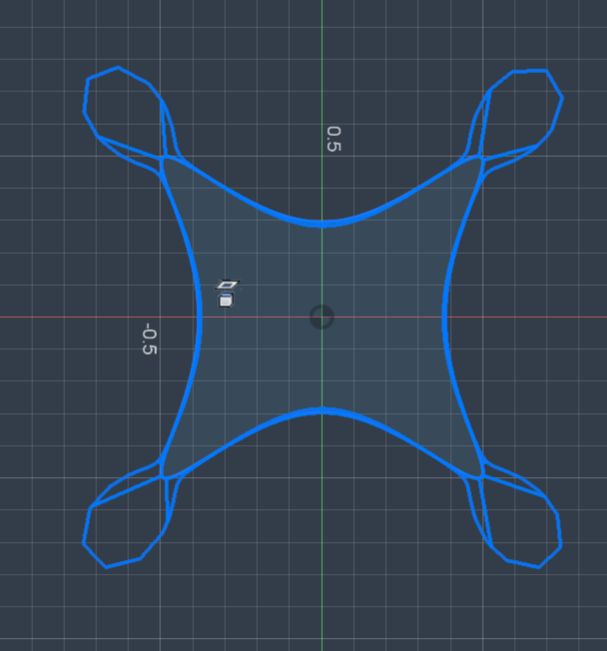

laughingcreek can you direct me to the "print sketch" function?  I'm not having any luck finding it.  When I right-click the sketch, there is no "print" option in the context menu.  Thank you!
Message 231 of 256
laughingcreek
I know everybody just wants a button to directly print a sketch, but the sketch does need to be laid out in a 2d space for printing first.  that's done in drawings.
create  drawing.
turn on the sketch you want to print.
lay the sketch out on the paper the way you want.
change line types if it's not set to one you want.
print.

Unfortunately, this requires all of the desired dimensions to be recreated.  It does allow printing 1:1 so it is better than just using Print Screen.

when this thread was started, there wasn't  any way to print sketches.  you had to extrude something into a 3d object first and print that.  you couldn't make a sketch visible and print that.  that's the point of this thread.

The Genesis was to print a 2d face TO SCALE.   1:1.  noting more.
Message 236 of 256
g-andresen
Then you create a drawing, select the format, if necessary a user-defined one, and print it to a PDF.
