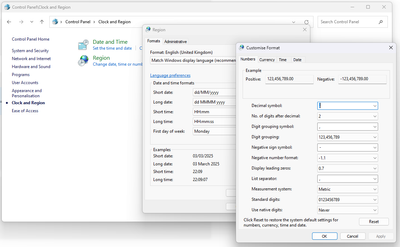

Hi, I like the idea and your program very much, unfortunately I get this error in the thread calculator as soon as I try to select a decimal number as a pitch.

MRWakefield
That's odd! It works for me:
I'm not sure what to suggest to be honest. The only thing that comes to mind is the regional settings of your OS. Your system isn't set up with a comma as a decimal separator is it?

Message 69 of 108
leo
I am from germany, so the comma will probably be set as decimal operator, do you happen to know how to change this?

leo
I found the setting and changed the decimal operator to a dot now it works fine. Thanks a lot for the help and the great tool.

MRWakefield
I found some information here: https://answers.microsoft.com/en-us/windows/forum/all/decimal-separator-changes-after-update-to-wind...
I'd be interested to know whether this fixes it for you. However it's not very friendly if you need to change your system settings to suit my program so I'll look into it.
Hope this helps.

leo
Yes this worked for me after changing to dot as decimal operator the thread calculator worked fine

MRWakefield
👍That's great but as I said, it's not very friendly. I think I've fixed it in the app so I'll be posting a new version in a few minutes. Hopefully it will also work for you and you can change your system settings back to how they should be.
EDIT:
Ok, it seems I haven't fixed it!!! I'll try again and do some more testing. I'll post an update when I've found a fix.
Right... It looks like it's fixed. I've tested it on my system with the OS decimal separator and thousands separator swapped (comma as decimal, point as grouping character). Let me know if it fixes it on your system.

leo
Unfortunately i only had time to test the new version now. Now it works perfectly, even with my standard os settings. Thank you very much and really incredible support that you provide for your application.
