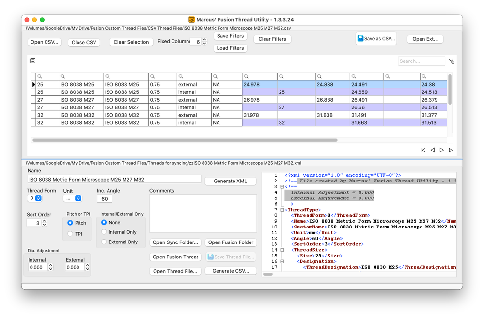

Every time someone asked for a custom thread (or a standard that isn't included with F360) here in the forum, or I needed one myself, I would think about writing some kind of utility to make the whole process easier, and each time I would mull over whether it would be worth investing the time for such an occasional requirement.
Well, some months ago I bit the bullet and decided I'd finally write something. It's taken a few months on and off and although I really wrote it for my own use I thought I might as well share it. If you like it and feel the need to give something back then you can send me a Ko-Fi tip
It can take an existing Fusion thread file and convert it to CSV (which can be edited in your favourite spreadsheet program) and it will also open a CSV file (of the correct format!) and allow you to generate a new thread file. It has the ability to adjust the Major, Pitch, and Minor diameters by a given amount to compensate for 3D printing (an alternative to adding an offset to the faces of the thread) or for creating in-between sizes (such as a TR21x4 - used on Sodastream CO2 cylinder). I've written a basic 'Rough Guide' that's included with the app but hopefully most of it will be obvious enough.
The app also includes a form for manually entering thread data and a calculator for non-standard metric threads. This took a lot of time studying the ISO standard to get the code right for this so was very relieved to get this part working! Maybe one day, when I feel like diving in again I might take a look at adding other thread standards.
Here's a screenshot of the main Windows application window.
Anyway, I hope some of you find it useful. You can download an installer from my ko-fi page. Hopefully you won't have too many questions.
Edit: I was reminded by @HughesTooling to mention the ThreadKeeper program for syncing custom thread files. I highly recommend it for making life much easier!
EDIT: I'm in the process of porting I've now ported this over to MacOS as well. You'll find the MacOS version on my ko-fi page as well. Be aware that it hasn't been signed or notarised so you'll get the usual warnings about potential viruses 'n' stuff. If you're worried just run it through a virus scan. Anyway, I hope all you Mac users find it useful. Let me know if you have any issues and I'll try to iron them out.

Ok, so I've been looking into making a MacOS version of the program, and after a number of dead-ends and jumping over various hurdles it's looking promising. After some tweaking, the fundamentals seem to be working, I just need to work out a couple of things regarding how and where Fusion stores various information on a MacOS system. Unfortunately I'm not able to install Fusion on my MacOS dev system so I won't be able to test it out, so I'll probably need some testers! Anyway, I think I've found out where Fusion stores its thread files so I'll start working on that next.
Here are a couple of screenshots:

I am trying to use this on the Mac, i dont know if I am using it wrong or if it needs work; I cant get the table to auto populate the generate xml button is always greyed out for me. When completing manual entry I fill in some of the fields add a row and it appears in the manual entry table but never shows up in the main table. What am I doing wrong I couldnt find a step by step guide or example I could use to validate if it is acting as expected?
Message 95 of 108
MRWakefield
Once you've got your data into the table at the bottom of the manual entry form you then need to save it as a CSV file. You then need to open that in the main form where you can convert it to an XML thread file for Fusion. I have considered making this workflow a little easier by prompting the user whether they want to open the new file immediately after saving it. I might add this for the next release.
I hope this helps. If you have any more problems just let me know.
