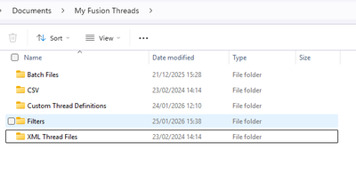

The CSV files don't have to go in any special folder, you would usually just save them to a convenient place. I save mine in Onedrive, but most people would probably store them in a subfolder under their "Documents" folder. Here's a screenshot of a suggested folder layout in Windows, Mac would be similar:
Let me know whether this solves your issue or if you need any further help.

So I went through the process again and it seems like your App is remembering the last folder it opened when you select "Save CSV" or "Save XML". but when you select "open Fusion Folder" it goes to the active folder where the active thread files are located.
I was able to get things working by selecting "open fusion Folder" button which opens a finder window.  Then I did the csv and xml generation which saved to the other folder and was able to select "show in finder" which opened another finder window.  then I was able to drag the xml across from that folder to the active folder, rename it and delete the active thread file.  after that the thread showed up in Fusion.

Yes, IIRC that's how the Mac version behaves. This has recently been changed in the Windows app so that each of the dialogues open in more sensible places according to whether you're opening/saving CSV or XML files.
The way it's supposed to work is this:
  • Save CSV files in any folder that makes sense to you.
  • Save XML files to a different folder to the CSV files that also makes sense to you.
  • Set the XML folder as your "Sync" folder. This simplifies copying your custom XML files to the correct Fusion ThreadData folder via the "Tools|Sync folders now" menu item. However, I would very highly recommend the ThreadKeeper add-in for Fusion as this automates all of the syncing and even performs an automatic sync whenever Fusion receives an update and rather unhelpfully changes the location of the ThreadData folder.
Unfortunately I don't have an actual real-life Mac to develop or test it on. I'm also not able to install Fusion into that dev system either. In addition to this, the environment that I use for developing the Mac version has a broken debugger (which I can't seem to fix, whatever I do). All-in-all this means that I'm not able to fully test and debug the Mac version to the same degree as I can the Windows version. I basically have to hope it works!
Let me know if any of this is unclear and I'll try to help. Anyway, I'm pleased you got it working, even though, when set up correctly is much simpler to use.
