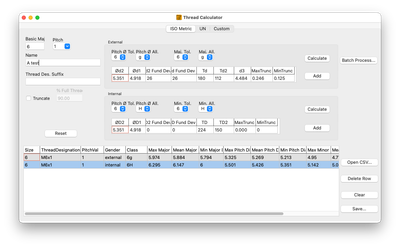

Every time someone asked for a custom thread (or a standard that isn't included with F360) here in the forum, or I needed one myself, I would think about writing some kind of utility to make the whole process easier, and each time I would mull over whether it would be worth investing the time for such an occasional requirement.
Well, some months ago I bit the bullet and decided I'd finally write something. It's taken a few months on and off and although I really wrote it for my own use I thought I might as well share it. If you like it and feel the need to give something back then you can send me a Ko-Fi tip
It can take an existing Fusion thread file and convert it to CSV (which can be edited in your favourite spreadsheet program) and it will also open a CSV file (of the correct format!) and allow you to generate a new thread file. It has the ability to adjust the Major, Pitch, and Minor diameters by a given amount to compensate for 3D printing (an alternative to adding an offset to the faces of the thread) or for creating in-between sizes (such as a TR21x4 - used on Sodastream CO2 cylinder). I've written a basic 'Rough Guide' that's included with the app but hopefully most of it will be obvious enough.
The app also includes a form for manually entering thread data and a calculator for non-standard metric threads. This took a lot of time studying the ISO standard to get the code right for this so was very relieved to get this part working! Maybe one day, when I feel like diving in again I might take a look at adding other thread standards.
Here's a screenshot of the main Windows application window.
Anyway, I hope some of you find it useful. You can download an installer from my ko-fi page. Hopefully you won't have too many questions.

OH BROTHER I think you did it. Now I am getting somewhere and it created the file in Fusion. Something major wrong with the thread but I will see if I can fix it and let you know.  Does FLANK ANGLE have any impact on this??
Thank you for your patients!!
Yes, Flank Angle for Acme is 29°.
EDIT:
Something to bear in mind is that IIRC ThreadKeeper won't notice if your custom thread files have been updated or changed. In this case you'll need to force a sync.
