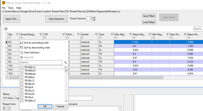

Every time someone asked for a custom thread (or a standard that isn't included with F360) here in the forum, or I needed one myself, I would think about writing some kind of utility to make the whole process easier, and each time I would mull over whether it would be worth investing the time for such an occasional requirement.
Well, some months ago I bit the bullet and decided I'd finally write something. It's taken a few months on and off and although I really wrote it for my own use I thought I might as well share it. If you like it and feel the need to give something back then you can send me a Ko-Fi tip
It can take an existing Fusion thread file and convert it to CSV (which can be edited in your favourite spreadsheet program) and it will also open a CSV file (of the correct format!) and allow you to generate a new thread file. It has the ability to adjust the Major, Pitch, and Minor diameters by a given amount to compensate for 3D printing (an alternative to adding an offset to the faces of the thread) or for creating in-between sizes (such as a TR21x4 - used on Sodastream CO2 cylinder). I've written a basic 'Rough Guide' that's included with the app but hopefully most of it will be obvious enough.
The app also includes a form for manually entering thread data and a calculator for non-standard metric threads. This took a lot of time studying the ISO standard to get the code right for this so was very relieved to get this part working! Maybe one day, when I feel like diving in again I might take a look at adding other thread standards.
Here's a screenshot of the main Windows application window.
Anyway, I hope some of you find it useful. You can download an installer from my ko-fi page. Hopefully you won't have too many questions.

Just to let any interested parties know that I've made a few additions to the app since I first shared it. It now has the following additional features:
  • Filter the CSV table on any column(s):
  • Calculate UN thread dimensions:
    The usual disclaimer applies to the thread calculators in that I can't guarantee the figures are correct so please check with another source if possible. I have checked and the figures seem to be correct but there's no guarantee!
  • Set a folder for syncing your custom thread files with the Fusion 360 thread folder:
Note that the app doesn't automatically sync you files so you need to do it manually with the new "Sync Folders..." menu item. I still highly recommend the ThreadKeeper add-in as it does the syncing automatically whenever Fusion starts up or whenever Fusion receives an update that moves the thread folder. Also note that these updates have been added at various times since the original version so depending on when you last downloaded a copy you might already have seen some of the earlier additions.
Anyway, I hope you find it useful

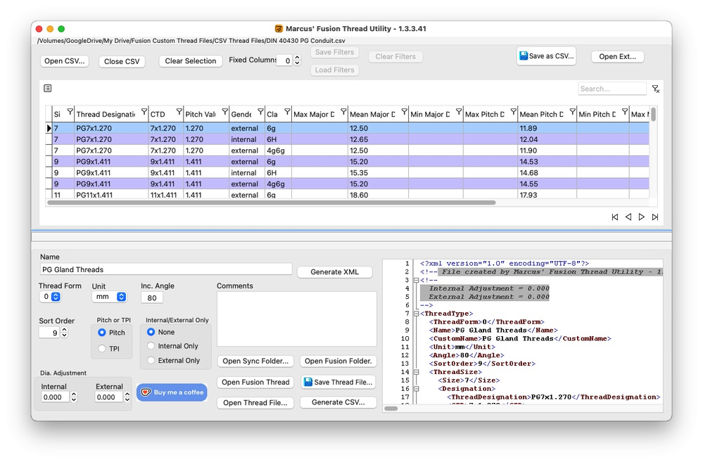

MRWakefield
I've recently updated the app to fix a couple of bugs, one where if a CSV field contained a double-quote (", ie to represent inches) it would mess up the data columns and another to do with batch processing in the thread calculator dialogue.
I've also added the ability to watch the Fusion threads folder and if the path changes then the app will offer to copy all your custom thread files to the new one. The app has to be running to enable it to watch the folder so I'd still recommend the ThreadKeeper add-in as it's definitely more convenient.
Here's a screenshot of the settings dialogue:
You will see that you can choose whether to copy the custom threads from either your sync folder or from the old Fusion threads folder. You also have the option to delete the old folder. I believe the Fusion updater would usually delete this folder but doesn't if it contains any custom files.
Hope you find it useful.

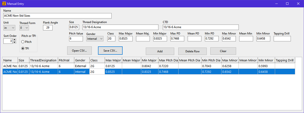

I am a little confused with this so I apologize I am not experienced enough to knock this out but this program looks extremely useful and I would like to understand better.
Can an entirely new thread be created with this rather than modifying an excising one? I am sure I am missing something here but I just can't grasp it yet.  I am looking to make a completely new AMCE 13/16-6" thread?
Message 12 of 108
MRWakefield
Yes you can generate a new thread file with the app. In the case of your 13/16-6 Acme thread you'll need to enter these manually. You'll find tables of sizes and calculators online.

Ok, I think I've fixed that. It was actually caused by a bugfix in a recent version! I've had to reverse that to make it work (it was to do with double quotes used for inches). I've only done some quick testing so hopefully it's all working again.
Back to the example:
As I said before, you'll need to enter the values manually for this one and you can find calculators online. In this example I used the one here. Here's a screenshot showing a 13/16-6 Acme class 2 thread for both External and Internal.
Just enter the values from the calculator along with the other information then click the 'Add' button. Do this for each designation. Once you've entered all the designations click the 'Save CSV...' button.
Once you've got your CSV you need to open it in the main application window to generate your xml thread file.
I'd recommend creating a folder for all your custom thread files then using the Thread Keeper to sync whenever Fusion receives an update. My app will do something similar but I'd still recommend Thread Keeper as it just does it all automatically.
Here's a screenshot of Fusion showing a screw and a nut with the threads created for this example.
EDIT:
I've attached the thread file shown in this example in case it is of use.

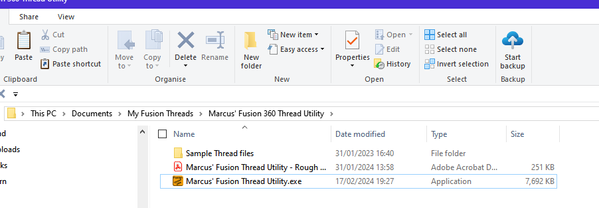

Ok, this is what I'd recommend:
  1. Create a folder in your Documents folder called 'My Fusion Threads'.
  2. Create a second folder inside this folder called 'CSV'. This is where you'll save any CSV files you create.
  3. Create a third folder at the same level called 'XML Thread Files'. This is where you'll save your XML thread files.
  4. Install ThreadKeeper according to the instructions.
  5.  Run Fusion then Change the ThreadKeeper directory to your newly created 'XML Thread Files' folder.
  6. Close Fusion.
  7. Expand the zip file containing my application and accompanying files to somewhere convenient (for example you could put it in the 'My Fusion Threads' folder you created earlier). In the future I might make an installer to make it easier.
  8. Create a CSV file using my app. As you appear to have already successfully done this then just move the one you've already made from wherever it is to the 'CSV' folder.
  9. Open the CSV file in my app.
  10. Generate the XML file then save it into the 'XML Thread Files' folder.
  11. Run Fusion. ThreadKeeper should notice that there's an XML file in the sync folder that isn't yet present in the Fusion threads folder and copy your XML file over.
Hope this helps. Sorry if I've missed anything obvious but I'm rushing back and forth between writing this reply and making dinner!
