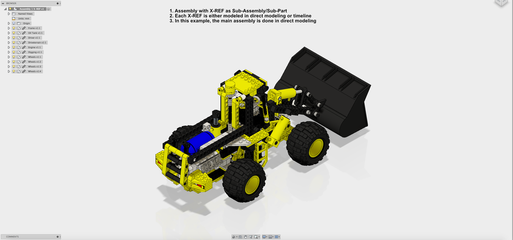

Option 2: Different Workflow (X-REF)
Using the current X-REF built into Fusion, the user is assumed to manually manage their own part and assemblies using components. For the sake of clarity, a part = a component that only has bodies and assembly is a component that has a minimum of 1 component (means it can both have body and component)
To better explain my points, please see the photos and description below it:
So upon opening an assembly, the user will be greeted with a bunch of linked parts. Since all these parts are linked, each has their own TL or if the user chooses so, DM, it depends on the design intent of the part. And at the assembly level, it’s up to the user to either use DM or TL. This means, TL or DM is constrained at its own component.
At the assembly level, user is not able to access the part TL unless he/she activates/edit-in-place the part. This allows scenarios like: parts is done in TL but assembly is done in DM or parts is done in DM but assembly is done in TL. Or better yet, a mixture of both depending on the design requirement. And guess we need to add an option like "create external component in-place" where it'll first do this as a part, and if the user creates more components in that, it'll become an assembly.
To make it easier for existing user, a new tool must be created to allow current components in a design file to be separated to part and assembly files
The upside of such method is it’ll allow the data panel to have a folder that’ll automatically keep track of individual parts iterations (each part is now individual version tracked instead of the whole assembly) and collaboration with different users (machinist, SIM and etc) is easier as it’s now possible to add restrictions to what users is able to access (e.g: Machinist only able to access individual parts and SIM only able to access whole assembly).
Pros: Easier to implement, better for collaboration cause of individual parts, improved part change versioning
Cons: Creates a different workflow which will mean added complexity to new users and tutorials has to be created on workflow recommendations based on the type of Fusion user, at the moment, using X-REF in Fusion leads to poorer FPS.
