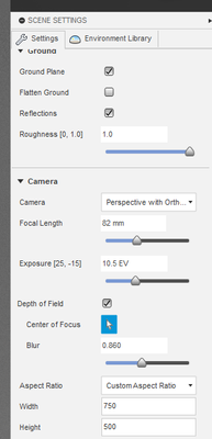

I can't seem to move the centre of focus for the depth of field in the render scene settings as per the image below.
Any ideas?

Yu have to click somewhere on the object(s)  in the viewport, A green dot (IIRC) appears where you clicked.
That is the focal point the DOF is evaluated around.

Thanks TrippyLighting. I have tried that. The dot is there but I can't move it.

With the "depth of filed" enabled and the arrow icon underneath also enabled , indicated by the blue color, you should be able to click on an object in the viewport and see the green dot move to that pint.

I agree, but nothing happens when I try!

It seems I can't move the dot on the main component but can move the dot to a different component but not back again!

Can you please expand the browser so we can see the contents of the bodies folder in each component?

laughingcreek
I think he wants the bodies folder expanded also.
is the body set to "unselectable"?
its a mesh body.  doesn't seem to be available for selecting.

Ok. Can I change that?
That is exactly what I tought!
@tomXMSG No, that cannot be changed. My suggestion for a workaround is to create a solid body in the spot you want to focus on and then select it in the render environment. Once you have the focal point set, you should be able to hide the object.

Forgive my ignorance but can a mesh be turned into a body?

I have been back to basics and implemented the 'hidden object'. Thank you both!
