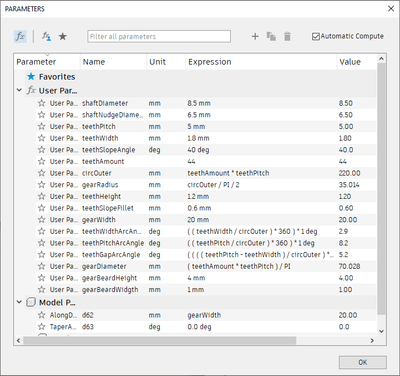

Hey there, i have been on it for a few hours today. (i know ...) It seems so freaking simple, yet i always get stuck.
here is a screen capture... run it with 10x speed 😉 there is no audio in it.
The teeth to teeth-Gap is assymetrical and i want to build it as good as it is in the shematic. (not only for training purpose but mainly for training purpose).
I calculated the helper lines by doing these steps:
  1. calculate the modulus: Pitch "5mm" /PI
  2. PitchCircleDiameter PCD= M*n (number of teeth "36")
  3. BaseCircleDiameter BCD = PCD*Cos(Preassureangle "20°")
  4. create a circle for the pitch circle (PCD)
  5. create a vertical helper line to mark half of a teeth
  6. create an arc with half the length of the teeth width "1.8mm" = ((1.8/2)/(PCD*PI))*360
  7. create a vertical helper line to mark the pitch
  8. create an arc with half the length of the pitch "5mm/2" = ((5/2)/(PCD*PI))*360
  9. build the slope with preassure angle, create the radiä for the edges etc.
  10. Realise something does not fit.
I'll give it one more and see if it fits tomorrow morning in the lab.

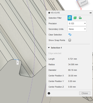

vonfinck
Hey Marcus,
Thank for the big help. With your help I simplified it and get how to do the involute as well now ;D BUT i am setting up everything strictly as per datasheet of the belts that i have. (sadly a whole box of these belts, so i would like to use these in particular).
https://www.optibelt.com/fileadmin/extranet/power_transmission/technische_Unterlagen/Datenblaetter/A...
But my design is always to small in comparison to what the manufacturers for t5 belts put out. I have two sample aluminium belt pulleys here but with the wrong amount of teeth. But they are good for testing of course. There, the belt fits perfectly. Mine ... pitch seems to fit but outer diameter not.
Maybe I just did a wrong formula somewhere?
I attached the file including the refrerence pulley.
I am absolutely gratefull for the help.

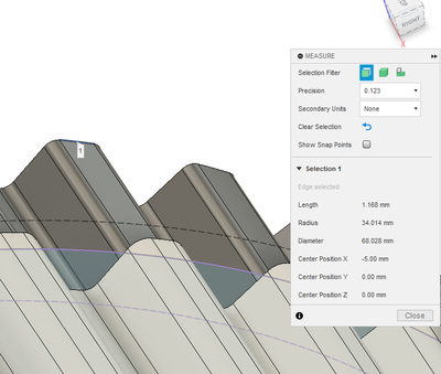

I've taken a quick look and compared it to a model I've done (see attached) and there are differences between the two. In your model you have an OD of Ø68.028mm and mine has an OD of Ø69.188 (which agrees with the reference pulley in your design).
Here's yours:
Here's the reference pulley in your design:
Here's mine:
So yes, there is an error in your calculations. If you go back to message #6 you'll see that the OD of the pulley should be 0.84mm smaller than the PCD, your OD is smaller by 2mm (this would agree with what you're observing with your 3D printed pulley(s) being too small). I notice that the included angle of your grooves are set to 40° whereas 50° would prevent premature wear of the belt (as previously mentioned). I also notice that the reference pulley also has an included angle of 40°, however this might be just simplified geometry as is common practice with vendor supplied models. In reality the actual pulley supplied is likely to be of involute form.
Hope this helps.
