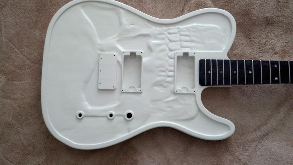

A few more pics to share.  I stay up way too late at night working in this thing.  Plus a photo of a guitar I have made before with my CNC.  This however is more of a challenge since the top isn't flat.
Message 60 of 73
in reply to: Anonymous
