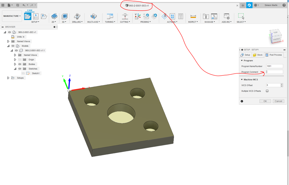

hello
does somebody know the file name expression?
i want to have the name of the file i am working on always show up in program comment on a new setup......

simeonX24F9
This doesn't seen to work. And it doesn't stay. Next time I go to edit it is
gone
