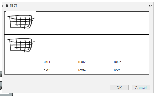

While trying to achieve a scrollable table with images and text (like the "Environment library" in the "Scene Settings") I encountered some bugs (or i misunderstood how to use them).
By creating a Table and adding some Images and text to it, I got this :image.png
the Text is not centered, the image covers the grid and by selecting the Text, only the shown part is highlighted.
By putting the Images in the first column, the result is even more... special:image.png
Looks like there is something really, really wrong. Is there maybe another way to achieve something like the "Environment library" in the "Scene Settings" or am I stuck with what I have?
