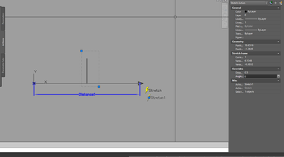

Hello guys,
Let's say I have a rectangle with a vertical short line which sits in the middle of its width. I mean that inside the rectangle I have a vertical line in equal distance from the left side and the right side of the rectangle. Image attached to demonstrate it. Let's say its a dynamic block meaning I can change the rectangle's width by linear stretch. I want that the short verical line would stay in the width's middle (if you're asking, it will used as a mirror / symmetry line). by the way, there is no necessity that the line would stay in the height's middle.

h_s_walker
Add either a stretch or move action to your linear parameter and change the distance multiplier to 0.5. See the image below

Libbya
...or set the parameters base to mid and add a stretch to each end.
