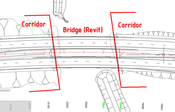

There are often times where the design of a road requires the corridor to stop at an angle other than that perpendicular to the baseline (i.e. at bridge locations).
Civil 3D currently has no way to skew a corridor region, and we must either stop the region short and fill in with feature lines, or extend the region beyond the skew line, extract the feature lines and trim. In either case, this results in an untidy corridor model.
It would be ideal to have an option to create a skewed corridor region. This can be partly achieved with a custom subassembly (see second image), but this is a bit of a hack, and does not actually skew the links at the desired skew angle (only the strings)

Add grip points at the end of each corridor region as in the sample lines to generate non-orthogonal endings.

I don't think a custom subassembly will do the job joantopo. Imagine you have a full road section and you need to cut everything, lane, gutter, curb and sidewalk.
Maybe a more general solution will be to be able to cut parts of an corridor, to be able to add a hide boundary to corridors.
doni49
I think the idea of a HIDE BOUNDARY could actually work pretty well.  The corridor would be processed as normal.  Then anything within the hide boundary would be removed from the corridor.
I can definitely think of several projects in which that would have been very helpful for me.

The trick to not define several regions is using 2 offset targets for each subassembly.
The first offset target is that diagonal and the second one is an offset alignment.
It is very important that the default width in each subassembly was 0.

I think the shape is not a problem. Think if you make a sample line and tilt it, same as AFTER picture above. In the sample line profile you see the shape. So Civil 3D knows how the shape should look there. Please tell me if I don't make any sense (so I can try to explain better).

I created an alignment across the corridor representing the skewed end of the corridor.   Then the links within that range used conditionals to see if that alignment was found before the FL was to be placed.  If not, then it allowed the creation of the FL.  This resulted in a skewed ending.
