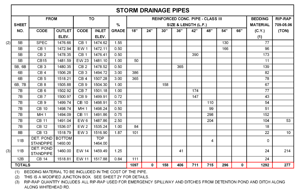

We need the ability to edit a C3D table like an AutoCAD table. For instance, a pipe table cannot be edited to add a user defined column, or create rows for headers that can contain merged cells. Below is what the Tennessee DOT requires for storm pipe and storm structure tables.
Example TDOT Storm Pipe Table
It is impossible to make tables like this currently in C3D that are dynamic and actually read the pipe network data.
It's also impossible to make a dynamic control point table in C3D that looks like the example below because point objects cannot reference alignments.
The C3D tables need to be AutoCAD tables that can read the model data.

The control points table can currently be solved with 3rd party help...the Sincpac-C3D Dynamic Linking for points allows a table exactly like you show to be created.

I think the object table in Civil 3D can be the same object table from AutoCAD, this allow us made a lot of different things.

It would also be very useful if the text summary table we can create was also dynamic.
jmayo-EE
This stuff would be real easy and versitle if AutoCAD fields could read Civil 3D objedct data...
Labels sure would be more versatile and flexible with this ability.
