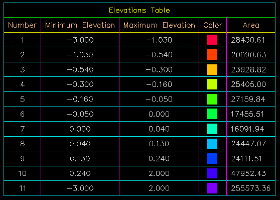

sirjoelsph
While complex calculations are not possible, you can add another row to the end of your tables and set the range to the entire range of the surface analysis for a total.  Here is a quick example showing a range of cut and fills and the total range as the 11th row.  You would still more than likely need some manual text to be able to label this appropriately, but the start of the idea is possible.
undefined
-JOEL
autoMick
Thankyou Sir Joel - I hadn't thought of that. Not the most elegant of solutions, but it is an option.
