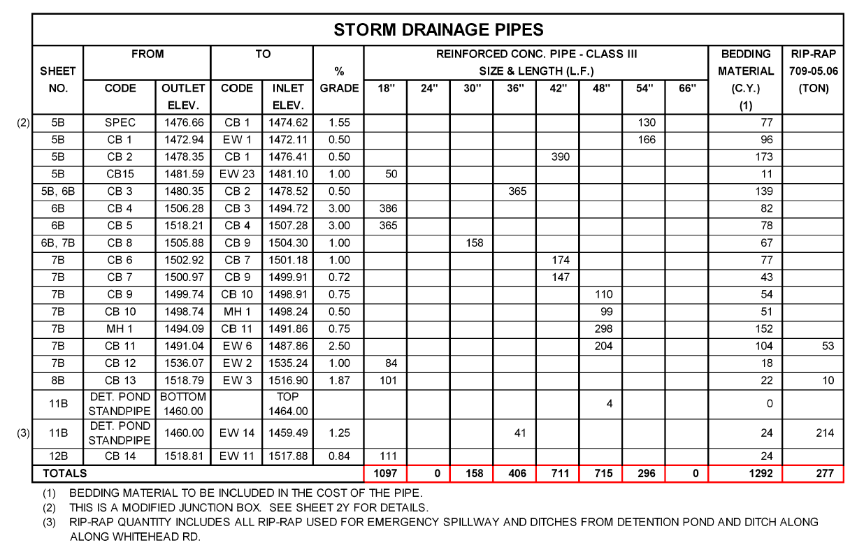

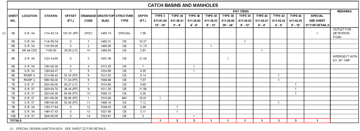

We need the ability to edit a C3D table like an AutoCAD table. For instance, a pipe table cannot be edited to add a user defined column, or create rows for headers that can contain merged cells. Below is what the Tennessee DOT requires for storm pipe and storm structure tables.
It is impossible to make tables like this currently in C3D that are dynamic and actually read the pipe network data.

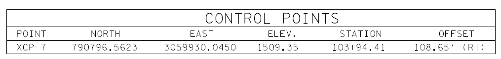

It's also impossible to make a dynamic control point table in C3D that looks like the example below because point objects cannot reference alignments.
