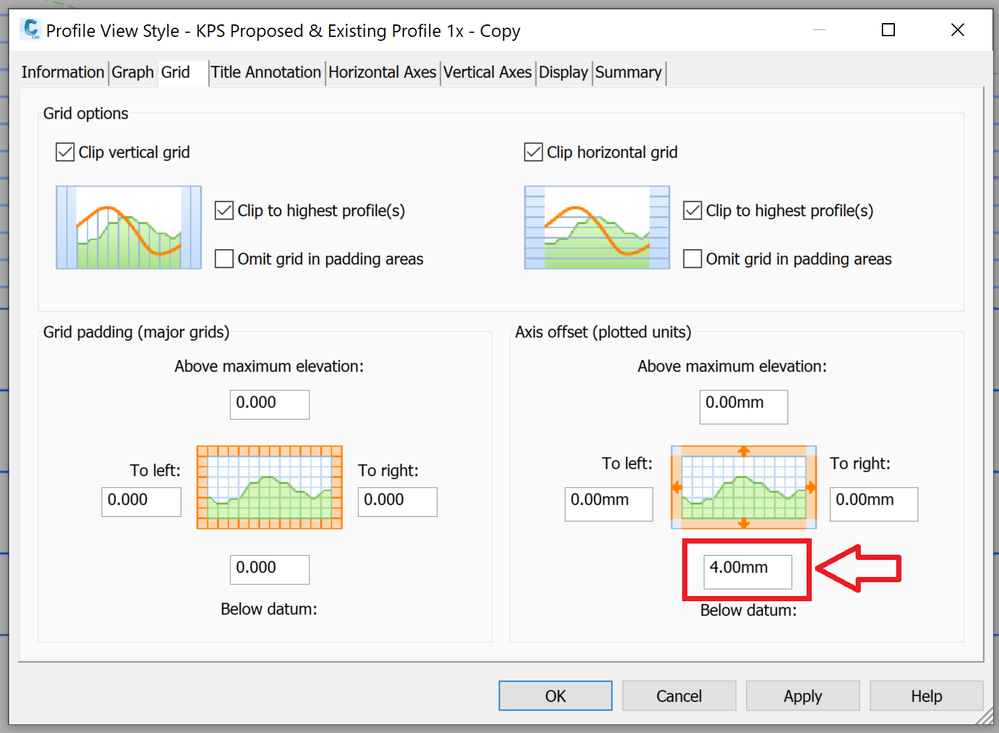

I think this is the problem. Try changing this from 5 to 4:
