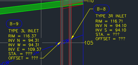

Got an interesting one here that should be easy to deal with, and yet I can't. Got a label style (see attached image) where we want structure name, description, rim and inverts, and then station and offset. The issue is the arrow and leader. If the label is on the right side of the structure and right next to it - it's fine. BUT, if it has to be moved anywhere on the screen - oy! I have to manually re-position the leader. Yet, I could swear there's a way to make it automatically move around. I tried changing the label style so that it's "stacked text" int he dragged state, but then the border doesn't display properly - I get a box around the whole label and not just the structure name. Is there any way to maintain the label's format and yet still have the leader be dynamic in its position/location?

imadHabash
Can we have a CAD dwg sample for the arrow and leader for both situation?

Joe-Bouza
That's nuisance. Here is what you do. Ortho on and pull the label straight up until you get a leader. Pin it. Now you should be able to grip and position without diving to mid structure

chriscowgill7373
What do you mean by Civil 3D label?  We know it is a Civil 3D label, which is why Ed moved your post.  There are many kinds of Civil 3D labels.  What kind of civil 3d label is it?  Structure labels have the ability to be modified as Joe described. I really think that it would be easier for us to help you if you share the drawing.  That way we could see how you did it, and offer suggestions that pertain to the dtyles you have created (including the possibility of changing those styles to provide the desired editability

chriscowgill7373
The Label's anchor point is set to the Structure Dimension.  Edit the label style. go to the Layout Tab, the first value is currently set to tie to the feature with the structure dimension set as the anchor point, change this value to label location and see if it helps

arobinsonTPUC7
Thanks, I did try that. It helped in that the labels now come in next to the structure instead of about a hundred feet below it! No idea where that came from. However, it still won't allow the leader to move about the label as I change its position. Thanks for trying.

chriscowgill7373
I have been thumbing through and trying out a lot of different settings.  What I have found is, the only way to get the leader to auto switch sides is to stack the text, but then you lose the formatting of your leader.  However, if you leave it set to as composed,  when the leader is on the left, you can click the diamond grip and drag it to right amd snap it to the end of your bubble, and it will move the whole leader to the right.  We use this method with several of our label styles, because we didnt want to create a left and right version of the label style, which also is an option available.  (Similar to having a bottom and top pipe label style for arrow head attachment to the top or bottom of thw pipe instead of the center)

ChrisRS
I concur with @chriscowgill7373 — you’ve run into a Civil 3D limitation.
Stacked text labels drag left or right cleanly, but they have formatting constraints, including creation‑order effects.
Assembled/Composed labels offer more formatting control, but they’re visually tuned for one side or the other. They rarely look equally good when dragged across the object.
That leaves three practical workflows:
  • Create separate left and right label styles. They stay clean, but you must keep both versions in sync whenever the design changes.
  • Use one label style and manually adjust the leader grip (the diamond). This is generally my preference — fewer styles to maintain, and you can correct the leader placement as needed.
  • Accept the stacked‑text limitations and avoid cross‑side dragging. Works fine if your labels rarely need to flip.
I do not anticipate Autodesk addressing this limitation in the foreseeable future.
