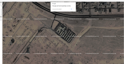

After using the map export command  then bring into QGIS The image is not coming properly it's asking to set ApI key
any advise please.
Message 14 of 16
TerryDotson
It's likely coming in properly, but the results are watermarked to prevent usability.  You can sign up with Google and provide credit card information ($$$) to obtain an API Key.
However, if you do some research, you will likely find similar or perhaps better quality images provided at no charge by the government agency covering your area of interest.
