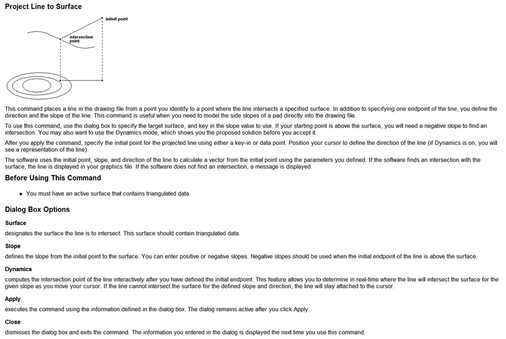

Hi Everyone
I'm relative new to Civil 3d, previously a Inroads users.. and i'm found what i use Civil 3d for to be very handy and easier than Inroads there are a few commands in Inroads i wish (i hope someone can tell me otherwise) were in Civil 3d.
Main on is a command in Inroads called 'project a line to a surface', i have searched the internet and some ppl have asked the question but have been shown the 'elevations from surface' in Civil 3d which is essentially 'drape to surface'
what i'm looking for is to project a single line at a grade (say 1:10) from a crest level of my design to an existing surface. when i move my mouse the line will get longer or shorter depending where i intersects with the selected surface.
I'm hoping someone with inroads background has tried to find this, knows it does or doesn't exist so i can move on with my life haha
thanks in advance
Andrew

Hidden_Brain
Is this what you are looking for in Civil 3D? I do not think there is a menu/button to do this, but can be accomplished using feature line(s) at the desired grade, creating temporary TIN surface from them and then by comparing the temp TIN and existing ground TIN (or using the minimum distance between surfaces command).

That is the command I'm looking for. Sucks that it doesn't exist. Handy for ramps from crest of an embankment to toe.

Neilw_05
Though C3D does not have an identical tool that I know of, you can achieve your task with a grading. To do this you draw a very small circle around the point you want to start from. Convert it to a featureline and set the elevation to match the elevation of the starting point. Next apply a grading that targets your surface at the desired slope. The resulting daylight line will be all the locations for a solution. Then strike a line at the optimal solution.
The circle you start with should be very small to keep the grading as close as possible to the true starting point location. I haven't tested this so I am not sure how well the grading will work from such a small circle.

Ranjit_Singh
See if the below lisp helps. It will use 2 points to determine the direction of a vector and then determine its intersection with surface.
