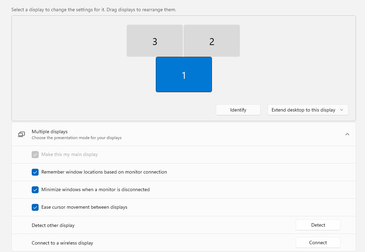

Update: the error appears in both AutoCAD 2025 and civil3d 2025. It also seems to happen to the first 25+/- lines in the ddlmodes. Right clicking after the first 25*/- that appear on the list seems to work. If you scroll down the list it continues to happen to the first 25 layers that appear in ddlmodes and not to the rest of the list (aka the bottom halfe of the list on my screen) This occurs on both computers in our office. The computers are not idetical both use navida brand graphics cards.
Message 29 of 44
mgallina
More info on Arithmetic error: I was able to find the trigger for the error and why some people do not get the error in the office! LOCATION LOCATION LOCATION! If the ddlmodes pop up appear above the location of you monitor that you main Cad screen is on it causes the error. If it is horizontal or below the cad screen the error does not happen. SEE Attached photo! (red area get error, and green area does not.) Location of screen is based on DISPLAY SETTINGS!
Please let me know if this helps. (As a test I dragged the ddlmodes to the actual AutoCAD screen and tested it)
Message 30 of 44
wbolin
This is really strange.  I use 3 screens. 1) is the laptop screen, 2) monitor, 3) monitor).  My civil 3d drawing window is on screen 2 (monitor).  I usually keep the layer manager window on monitor 3.  I get the error when "Layer Manager window" is on either monitor 2 or 3.  I DO NOT get the error and it works perfectly when Layer Manager is sitting on screen 1 (laptop).

Message 33 of 44
mgallina
note: The physical location of the screen is not the issue. It is where the screen is located in "display settings". See my left screen in photo attached. (it matches the physical locations of my monitors)
Message 34 of 44
wbolin
I was trouble shooting more.  My set up is 1) laptop display, 2) monitor, 3) monitor.
display 1 is set as "Main Display".  Right Click on Layer Manager only works when the window is on Display 1 (laptop as main display).  It does not work on 2 or 3.
When I change the "make main display" to 2 or 3, right click on Layer Manager works on all displays.  It's a strange bug, but I can proceed with layer manager sitting on Display 1

mgallina
See post above where I show the windows screen settings. Having the ddlmodes layer pop up on a windows setting  screen location above your autocad location will cause this problem. I have moved my pop up location to be beside or under and it works.

Alfred.NESWADBA
Hi again,
well, verified, and the workaround to:
  • work with AutoCAD on the lower display ... or
  • arrange the displays (inside Windows) so all are vertical on one plane
..works well.
Thank you @mgallina  for identifying this!
- alfred -
