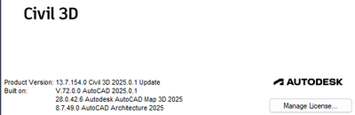

neilyj666
@MSBryan No issues with right click to create a new layer for me - have you also installed the AutoCAD 2025.0.1 update?
neilyj (No connection with Autodesk other than using the products in the real world)

michael.bryan2FADE
Yes the update was included in download executable. but i see I have a V.58 whereas you show a V.72. I had done completely new download of the software after I deleted the original. Will investigate.
Message 20 of 44
neilyj666
Yes it is the AutoCAD update to 2025.0.1 rather than the Civil uprate to 2025.0.1. May not make a difference but the Layers are a core AutoCAD thing not specifically Civil
