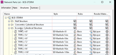

brian.strandberg
Yep - its all in the part list.  Anytime you data shortcut something you are only getting the data, not the style.  Having the same part list in both drawings, helps it get it right.  Its going to look at the part list, in my case the structures snip below, and it will use those styles. When it sees an eccentric cylindrical structure, it will look at this information for which style it will use.
