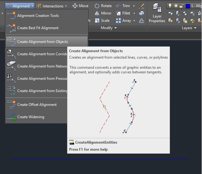

I am trying to create an alignment from a series of polylines. I scaled a PDF to actual size in model space but when i create an alignment from the centerline, the stations are spaced along the line at 4' intervals rather than 100'.

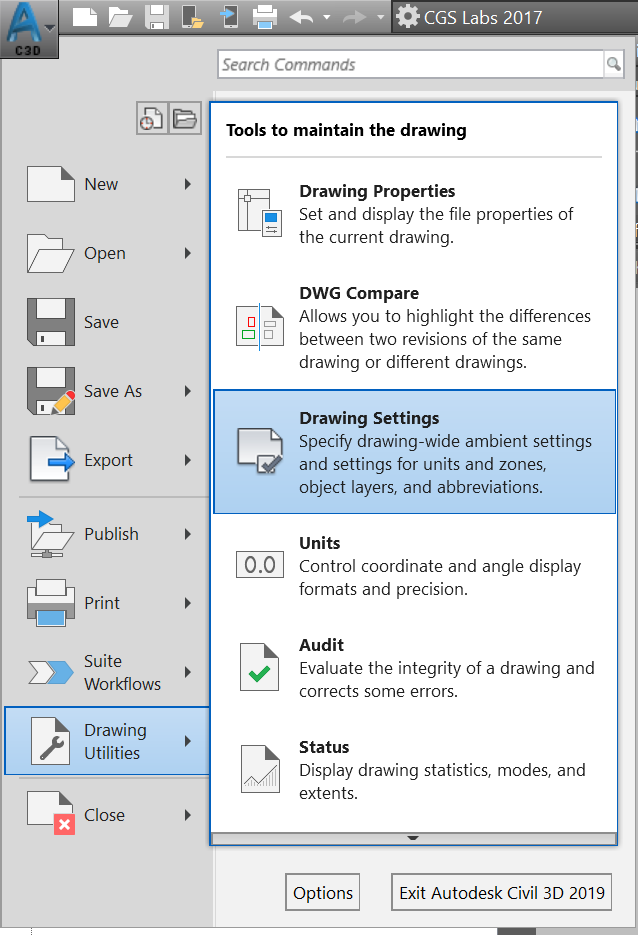

ilia.borisov
Try to change units settings from here
Message 9 of 22
I seem to have the same issue when I change everything to feet and vice versa to inches.

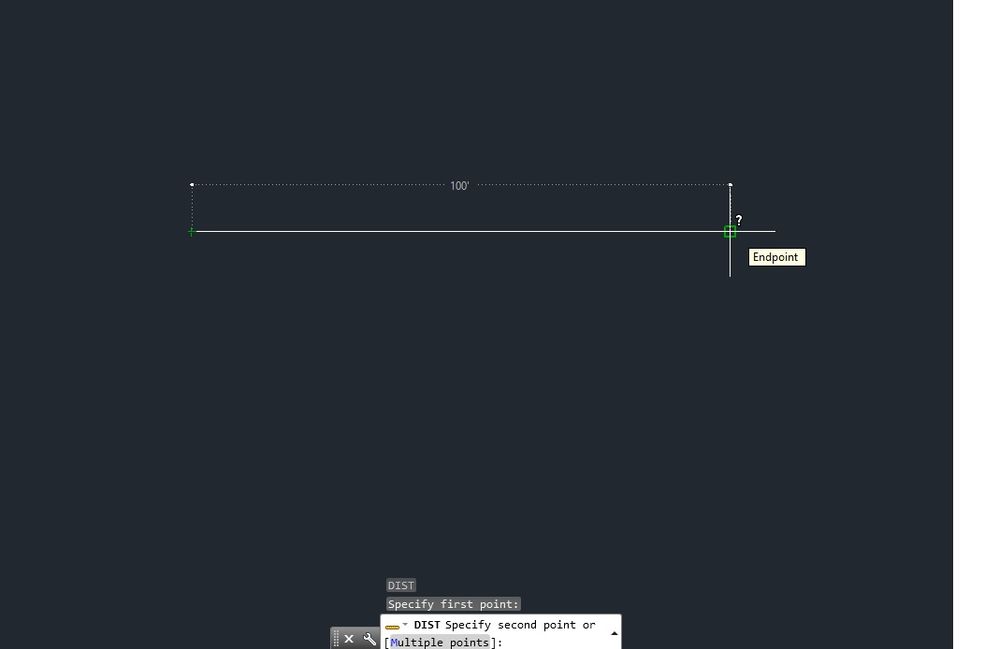

here is a step by step of what happens when I make an alignment out of a 100' polyline.jpg4.jpgjpg5.jpgjpg6.jpgjpg 7.jpg
the length of the alignment comes out as 1200' (obviously some sort of inches vs feet issue) I just cant seem to pinpoint why the alignment scale does not match the scale of the line.

ilia.borisov
Message 12 of 22
unfortunately im finding that changing all of these units is only changing the units the station is diplaying and not solving the problem that my alignment length is always 12x the length of the line/polyline used to create it...

attached
Message 18 of 22
LucasHicks
Your units are set to Architectural in the lower right of the screen.  Change to decimal and you'll see that your line is 1200' long in the properties.
