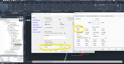

I'm trying to create multiple section views (SV) that contain two surfaces but am having difficult getting reasonable elevation ranges. I've tried many different combinations when adjusting the elevation settings in the multiple SV wizard with no luck. For example, I've selected automatic and user specified (all options) ranges. The alignment elevation change is only 2 feet (978 to 980) but the SVs have a range from 950 to 1000 which makes them difficult to read. The cross sections also don't have more then a 3 foot elevation change.  I've used a vertical exaggeration of 5 but I'm not sure if that matters. See attached picture for screen shot.

ilia.borisov
Set that setting to 10 and try again

@ilia.borisov Still doesn't work. I've tried adjusting the profile view using multiple heights and the elevation still starts at the same place, 950. So when I change height to 10 I don't even see the surfaces. I've tried this with the height measured from mean and lowest section elevations and follow a section options. The attached  screenshot is with a height of 10 from mean section elevation.

The minimum elevation in all the section views are 950 (see screenshots from previous posts). The sections elevations are around 978 to 980 +/- 3 feet. My problem is that i cannot seem to change the range for the multiple section views (SVs) to something closer to the actual section elevation ranges. Thanks

can
Community Visitor
Community Visitor
Hi All,
You should try to change horizontal and vertical axes intervals from Section view style
Please find attached screenshot.

Many years ago I did a class at AU which may be helpful.   I suspect that the major grid settings in your section view style are part of the issue.
Page 4 in the handout.

Amy.taylor
Can confirm this is the solution I needed.
Adjusted major intervals for all axis and it adjusted immediately.
