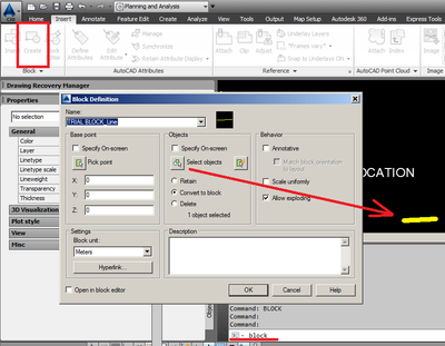

АлексЮстасу
Hi, @Mikolaj.Biernacki,
Blocks A - BOREHOLE and TRIAL BLOCK do not contain either Line or Point. Therefore, they are not visible in the MAPIMPORT list.
The TRIAL TRENCH LOCATION LEGEND block contains a Lines and is therefore seen by MAPIMPORT.
(This is my ridiculous hypothesis, but it works).
1. Create a new Insert-Create block or call the _BLOCK command.
Select any Line or Point to create the block.
2. Open this block in the block editor. Insert the desired objects, attributes, and so on. But you need to leave at least one Line or Point in the block.
Save the block.
This block appears in the MAPIMPORT list.
