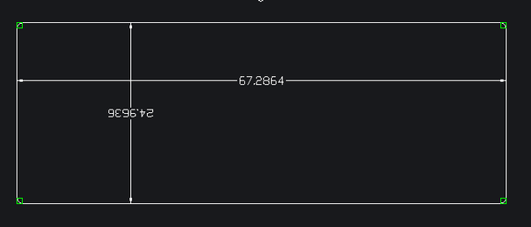

Dimension text upside down
bidhin_patel
My UCS also moves while I am dimensioning. I don't remember if it was happening before but I don't want it.
Please Help.
Thank You

Set the commands UCS and PLAN to WORLD first, then find out what is truly going on in your file.

It is happening because when i select points, new axis guides dimension text where to display @pendean

h_s_walker
Your UCS is still upside down. The Y in your first picture should be above the line not below.

@bidhin_patel wrote:
...It is happening because when i select points, new axis guides dimension text where to display @pendean
Once your UCS looks like this (see below) in a new file (or your current one), your issue will go away, see tips I already provided to get there

bidhin_patel
It is solved i by mstake clicked on DUCS.
