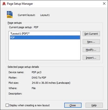

First, the page setup manager does indicate there is an "active" page setup:
And it does show in plot dialog like you said.
That may indeed be the answer here, and the plot dialog behavior threw me off.
I never really cared much either, that was most of the reason.
This is great, I will make a couple named setups and see if the SSM command uses the active one, as opposed to last used settings.
