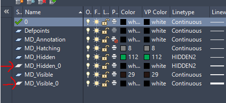

I have the MD layers created and linetypes set in my drawing template, but all of a sudden AutoCAD started making additional MD layers with _O at the end of them.  I can merge them into the original layers but have no idea why AutoCAD is creating them.

In model space, I'm selecting geometry and typing vbase.  I'm selecting layout 01.  At that point, my MD_ layer goes from this...
to this...
see attached file.
Thank you.

Alfred.NESWADBA
then drawing you attached already has the "_0" layers, so I
  • deleted the viewbase object in the layout
  • purged all layers
  • started again command _VIEWBASE to create a new view in layout 01 from the modelspace content
...even if I start this multiple times I don't get any "_0" layers. If you follow this workflow, do you get again the "_0" layers?

dcolley_ptfnola
I did that and i didn't get the _O layers, but now I have all my template layers (including the pre-defined MD_ layers) gone.  That worked, but I lose my template layers and layer properties.
Maybe I'll try to purge them out of my template and recreate them.
>> and recreate them
Did your template already contain the "MD_"  layers? If so this could be the source of the issue.
Try to purge all "MD_" layers from your template.
Then create one 3D-Solid, run one time command _VIEWBASE so you get the "MD_" layers created. Change the layer properties for these new layers to your needs. After that delete the viewbase-object from layout as well as the 3D-Solid object from modelspace and make this your new template.
Does that work for you?

dcolley_ptfnola
Must have been something in my template .dwt.  I purged out those layers and recreated them.  All seems good for now.  Thanks, @Alfred.NESWADBA .
