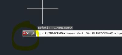

Previously in ACAD 16 the command line was outside of my drawing window. Now (?) It is inside and it blocks my cursor when I am dragging or moving or anything. How do I get the command line parked outside my drawing window? Having text of what I am doing planted in front of me is annoying. Help!!

cadffm
If you really tank about the commandline: drag the commandline to the statusbar,
the shape changs to the full wide of program window, then drop it.
Not it is "docked".
Or do you talk about the dynamic input option? Set Dynmode to -3
If it doesn't solved your problem, upload a screenshot (and mark what you called "commandline")

Message 6 of 16
cadffm
You know what "drag&drop" is?
drag
Click and hold the left mouse button (at the point you can see in my picture)
move the commandline (while holding the left mouse button)
drop
release the left mouse button (if you can see that the shape of the commandline changes, if not, try to drop it in the lower section, near the statusbar)
Sebastian

Message 10 of 16
Thanks for the help, Non of this worked;
1) The command line is inside my drawing at the bottom of the page, above the old status area. I can't drag my cursor thru it when I am drawing, I have to pan to get by it. Before it was out of the drawing area, now it is about 1/2" thick and about 3" wide, before I use only 2 lines & they were all the way across the screen and it did not interfere with my cursor. I have use every sort of attempt to relocate it but I can't get in, stretch, move, nothing
2) Now when I open my drawing about 2" of the drawing is not seen at all, because it is buried below? I have always had full screen view of my drawings. Limits have been set, full view is set..........nada.
3) Also there is a another (temp. ?) command line that pops up every time I use a command, mouse or keyboard. For some reason it is showing everything I am doing up to about 5 lines of text. All of which blocks my cursor (see 2). Why is this being written at the bottom of my drawings?

Message 11 of 16
Alfred.NESWADBA
Please show a screenshot of your AutoCAD application window so we see which style your command-line has and where it is positioned.
Sounds like the command-line is NOT docked (moved downwards to the statusbar until you get a rectangle displayed and then release the mouse button).
- alfred -

Message 12 of 16
Hi Alfred. Right, the problem is I can't dock or undock it's like frozen
there. All just happened one day.

vinodkl
Looks like you UI has been locked. Type in the command "LOCKUI" and set it to "0".

Alfred.NESWADBA
can you please create a screenshot from what you have now?
Please follow these steps:
  • start command _CUI
  • on the left side select on your current workspace (the one marked with "current")
  • then on the right side/upper half open "Palettes" and select "Command Line"
  • change the settings to the ones in the screenshot:
