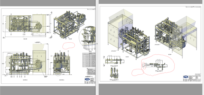

Hello.
Just noticed this issue today that I haven't seen before. I used the publish command to plot the multiple tabs in my drawing, which I've done many times. I had revisions on some of the sheets which I clouded. But for some reason, on one sheet, the cloud plotted/shown as red (which is correct and what I prefer to see) and on another sheet, it is shown as black. Why is that and how do I fix? Thanks in advance for the help.
All clouds are on the same layer and the layer color is red and I'm working in Autocad 2016.

Message 2 of 22
rkmcswain
First guess would be that the plot style table was unavailable during the publish session for some reason. Did other layers/colors in those prints come out obeying the plot styles?

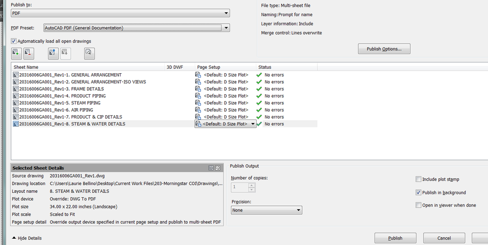

lbellino4
Well, my publishing settings is going to a PDF and the page setup for each of my drawing tabs, the plot style table is set to "None". Being set to none, normally prints in the colors on the screen. See images attached.

lbellino4
I plotted the pdf that I created with the publish command to a color printer and the clouds that show red, printed in red and the clouds that show black, printed in black.

lbellino4
Attached is the new pdf of one of the sheets that was printing the clouds black instead of red. It's still printing the wrong color. And I tested this out using two pdf options which is, "AutoCAD PDF.pc3" and "DWG to PDF.pc3" and they both printed the clouds in black. Image below shows the one option.
