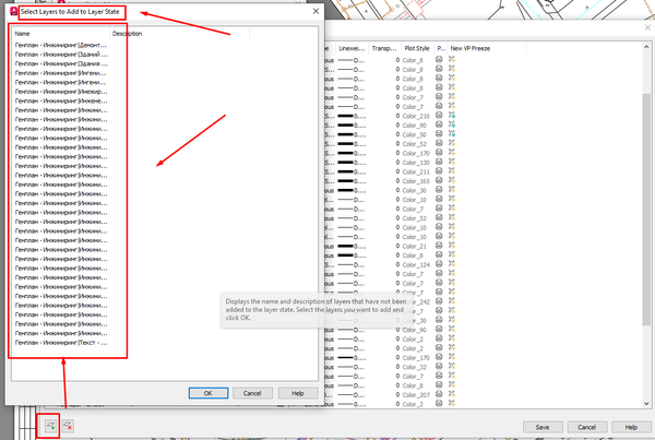

alexandresynth
it IS a mistake, stop fool yourself and the others. Also remove the title of expert in autocad from your signature.
Are you an real user of AutoCAD? Really? Or u are just a teacher? Send me your project i want to see it, because is just IMPOSSIBLE u do a real full architecture project without use the layer states, is just impossible! How will u deal with a million of layers in your face turned on at same time??
Without layer state
With Layer state
I NEVER changed the overwrite configurations of layer inside the late state, i even think an interesting idea for some occasions but i NEVER used. All the changed i do are in MODEL but the problem is that when i go to layout i never over and over again choose the layer state for each viewport in each layout and any change of layer (color, tickness, printable or not, transparency, etc...) when i change the layer state all them are LOST FOREVER!!!!!!!!!!!
The only way to keep them are 2:
1 - Or i delete all layer states, do the changes i want in layers and then create one by one again.
2 - If i choose each layerstate, perfomance all changes in each layer (in model, not editing anything inside the LAS layer overwrite) and then i open the LAS and click in update. After that i need to choose the next layer state, performance the same changes in each layer and update again, is not "only 1 click" as u said.
What happened was the following: the programmers programmed this resource, the system analyst did a very poor test because he wanted to go home fast to play Age of Empires, so hr gave his OK and it was published without further investigations and tests and we real users (not you) are paying the price of that tester 10 years ago until today. And it is still alive despite many ppl complain about the same problems in many foruns in many countries because ppl keep defending that is not a bug and we just dont know how to use.
It carries a BUG inside, everyone who read this in the future keep it in main!
You click in ok but it will not be saved, you change something and this change does not stay.

I added a xref that i want to displayers their layers only in 1 sheet (only in 7-7 СПИС) the others layers states didnt carried the layers of the xref, as you can see below.
I didnt click to add, so the layer state didnt know about the existence of those layers, and i kept checked the box "turn off layers not found in layer state", and autocad even did it, indeeed i went to first viewport, choose the layer state 1-7 Схема УЗ, autocad shows the right layers, i went to the next layout, choosed the right layers state, until the seventh, when i print, the layers of the xref were displayed in ALL SHEETS!!!!!!!!
And then will come an specialist here and tell me it is not a bug.  how much u bet? Man, how much AutoCAD is paying for you do this to me?

you didn't shared enough detailed information and no .dwg attached, so we have still to guess some things.
We can not see where are texts placed model/paper or which layer setting are current or stored in the layerstate.
>>"I never performanced changes in VPCOlor or VPLinetype"
Your picture states: They are all overwritten! (the STATUS column states this)
And this fact matchs to the screenshot of your layerstate dialog (the "apply as VP overwrite is turned ON)

@alexandresynth
It looks like (in your posted images) your are using an External Reference" (XREF) in your drawing.  When your close a drawing containing an XREF and reopen it, the layers from the XREF will be reset to the saved state of the drawing they are in UNLESS the variable VISRETAIN is set to 1.
