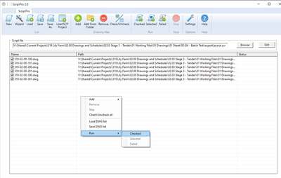

Hi Ed.Jobe, I'm not sure if it was unclear but I was hoping to automate t he processing of layouts across multiple separate files. Exporting multiple layouts from the same file can be done easily using the built in EXPORTLAYOUT command and shift selecting the tabs.
I think thats where the script is failing maybe?
Message 22 of 42
Ed__Jobe
My script runs the EXPORTLAYOUT command for each layout in the dwg using Visual Lisp. I told you that LT can't do those commands. The script will only work on full AutoCAD. LT may be able to run the script, but parts of it will fail.

Here is my process:
then i select the files I want the script to work on:
The run the script on selected files like this:
This is the result:
Is there something else I need to do?
Sorry this is being such a pain. Im sure it will be beneficial to others if we reach a solution though...

The first two failed for me due to missing xrefs and missing sheetset. Those two prompts cause the script to fail.
Ed

So any pop up prompts will cause a fail?
Message 38 of 42
cadffm
ScriptPro setting:
linked to accoreconsole.exe or acad.exe(choose acad.exe. if not done)
Sebastian
Message 39 of 42
Ed__Jobe
Yes, if there is no way to respond to them. Also, Sebastian had a good idea, check SciriptPro's options to point to where your acad.exe is installed.
