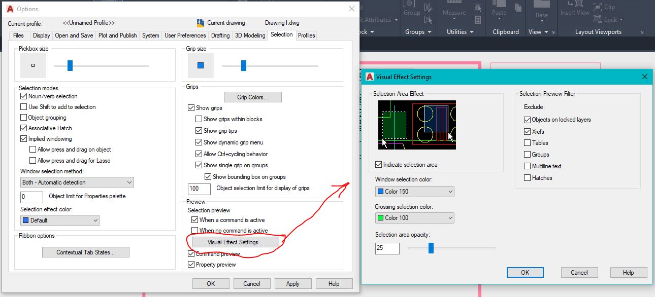

Are you saying you don't have the "selection preview"?
If that's the case, click the "Big Red A" and select options, then go to the "Selection" tab, and check all of the options you want to use. It may take some experimentation to get what you want and turn off what you don't.....see attached for example.
Hope this helps, if not, can you be more specific?
