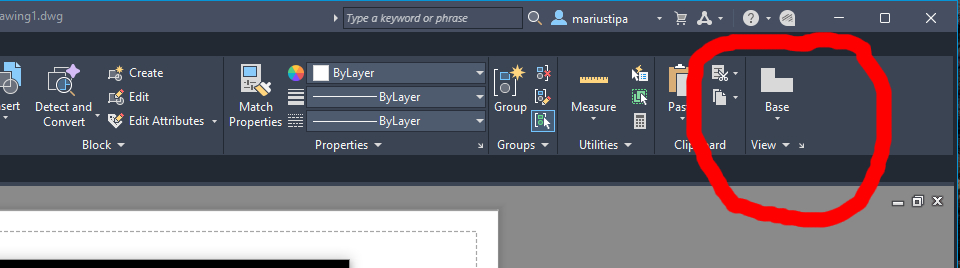

The base command in Autocad is not working since 2023 version. Base from Model Space or Base from Inventor ... is doying nothing.
Also there is a loop in installing something when launch Base command but I got no clue what.
Any ideea please?

mariustipa
This is the command - see attach

mariustipa
The Inventor plugin INVINTEROP_2026.exe can't be installed. It takes me into a continuous loop.
It is amazing how they make this software really a garbage.
See attach please.

mariustipa
From Model Space.

mariustipa
Actually it is called BASE from the menu.
