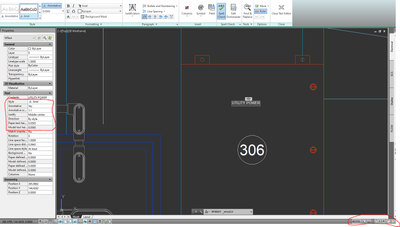

Hello again. I have a couple of questions. I have been reading through the link posted above and following the steps.
https://www.autodesk.com/autodesk-university/class/Annotation-Scaling-AutoCAD-Bringing-Technology-Ho...
So I have used the CHSPACE command to determine what my actual text size is on paper space. For example on my shelter layouts, the text size in paper space is 0.0565 and in model space this size is 1.5.
I am drawing a 1:1 scale in model space and I have modified my text style to be annotative.
The screenshot below shows my text being 1:1 since I typed it in model space but it does not automatically scale based on my viewport and I have the automatically add scales option selected.
Under the annotation scale in the properties menu, I see that I can add delete scales but since I always just zoom my paper space viewport to extents, that scale does not exist within the texts scale list. Is that an issue?
I notice if I add the 1/8" scale, then the text definitely does become annotative and change based on my viewport zoom level.
The second screenshot is of my page setup, just for reference of my PDF settings.
Forgive me, but if you are only in MODEL how would AutoCAD know which portion of your modelspace content is in a viewport in a layout in your file? And why would it know which CANNOSCALE to set?
I'll tell you how you can simulate all of that though: go to your layout, double-click inside your viewport then start VPMAX command (VPMIN command to get back to the layout).
If you only ever want to work in MODELspace, and find the tip above too much to wrap your head around, then you yourself on your own ne deliberately need to change the CANNOSCALE from 1:1 to the plot scale that viewport in that layout needs to be. Then change it again for another portion of your MODEL content that is at another viewport-in-a-layout scale

the screenshot below is the same drawing, in the layout tab, within the model space.
