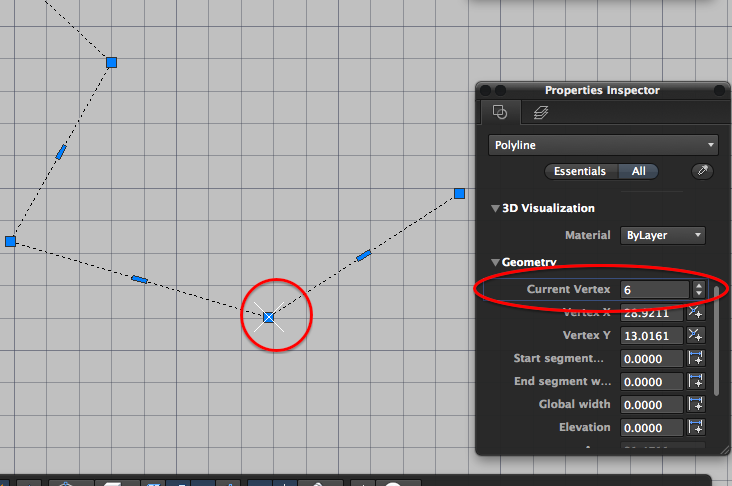

Select polyline and walk trough the vertexes in Properties Inspector:
when you will see that after you change vertex number the white cross marker doesn't move - then it is the place of zero-length segment.

Thanks for the clarification.
I have checked and there are no zero-length vertices in the object.
