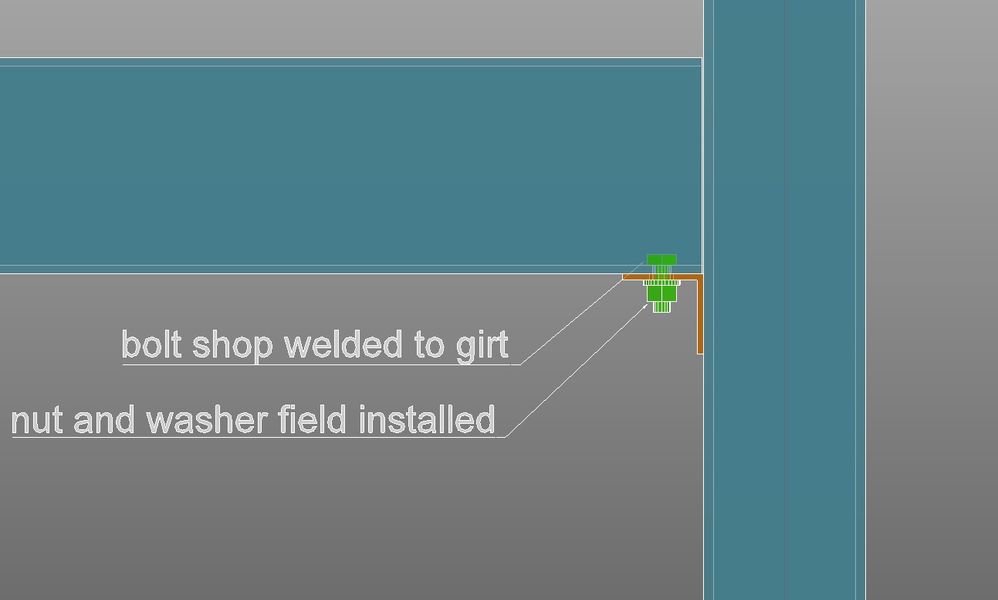

Below is an example of an everyday case of girt to column connection, bolts are tack welded inside the HSS girt, nuts and washers field installed. This may be temporary seat so HSS girt will be welded all around after that. Or can be a part of a permanent connection.

acbsdesign
@DumitruBerteanu
Hi Dumitru,
As an addition to the case above, nut can be shop welded inside the HSS girt.
A summary:
1. Holes to be done by the bolt
2. Shop or field weld bolt, washer and nut field installed
3. Shop or field weld nut, bolt with washer field installed
4. Shop welded Nut or Bols to be shop Nut or Bolt, listed in Extrenal lists and BOM on dwgs as shop hardware
5. Field installed bolts or field installed nuts and washers-listed as field hardware in external lists and in BOM on dwgs
Thank you again and have a great afternoon.

Dumitru,
A "Captive" bolt, stud, threaded rod, nut or washer is typically welded to an object in the workshop. It typically has a mating nut & washer or bolt & washer, which is supplied loose to site. The item welded to an object in the shop will need a individual item number and be included in the BOM on the assembly drawing and on any workshop BOMs. The items supplied to site will need to have their own individual item numbers and be included on the site bolt list.
If a bolt, stud, threaded rod, nut or washer is weld to an object on site then I would include these on the site bolt list as individual items with individual item numbers. These can then be called up on the GA (erection diagram) where required.
In Australia, a stud is a partially threaded round bar (like a bolt without a head). In some instances a stud can be threaded both ends. A threaded rod is a rod which is threaded to its full length. A stud or threaded rod can also have multiple washers and nuts. It is not unusual to have a threaded stud or threaded rod with washers and nuts both ends.
The individual bolt, stud or nut which is welded on should be able to create a hole to suit.
The "bolt assembly" created from these individual parts needs to be able to connect multiple objects in the workshop.
I think the important thing here is to be able to insert bolts, studs, threaded rods, nuts and washers as individual items and for them to be tagged with individual item numbers and be nominated as "site" or "shop" items so they can be easily included on the appropriate BOM.
I hope this helps. I am happy for anyone to comment or add there own ideas. Thanks.
