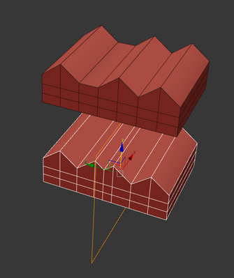

Does the proximity weld work for others in 2022.2 ?
I can't get "non slice pair" vertices to weld (e.g. for a quick and dirty cleanup) no matter how high I put the treshhold.
Alternatively, it would be nice if the sliced edges or the vertices of the slice/weld were passed up the stack as a selection so they can be processed further automatically. I can use open edges in case of an unwelded slice, but there is no guarantee there won't be other open edges.
Additionally, the slicer still messes with hidden edges outside of the ones the slice plane cuts. Probably because it considers the whole polygon, which does make sense for editable poly, but naturally, it won't always find the best solution when retriangulating bigger polygons.
Extreme example to illustrate the problem in the attached picture.

Did you test 2022.2? It is fixed, and if you turn on Use Proximity Weld, it should use older version algorithm. If something is still not working, please send files to dev.
Also if you have not jointed beta, please join.
Message 58 of 87
gandhics
"non slice pair" vertices to weld is working for me. Did you make a fresh new Symmetry modifier or using old file?
Message 59 of 87
gandhics
Also I can;t reproduce the issue. Could you upload the file?
