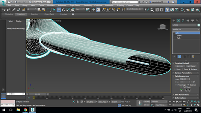

Hi. After my 3D max has updated in this year, my multiple shape loft stuff was very ugly do it ( screenshot i do it the shapes with lines and lofted. ). now i can't get the second shape to use in the same loft. is there a new procedure of steps to get the second or more shapes after the first shape loft? i want to loft an egg shape ( standard one from SPLINES ),than the ellipse shape than again the egg ....  and so one.  thank you.

Chance are that there is some XForm history in there.  I did a test (attached) and it seems to be working ok on my end.  I have used this tool a lot and one thing I've found is that the best way to fix the problem you're having is to select those shapes that are giving you problems, then right click on the move icon and right click on all the spinners to put the shapes in the center of your world.  Then Reset the Xforms on them at the same time, convert to edit spline, and try again.   This isn't a new issue though, it's just an old tool.
Another option is to go into the subobject mode for your middle shape and rotate it to fit a bit better.  You probably already know that though but figured I'd mention it.
If you still have problems, attach a sample max file please and I'll take a look and offer suggestions.  Thanks!

  In this picture i  do it in LOFT->DEFORMATION-->SCALE
Question : how can i remove the shapes and remain just the end product there? Is this possibble ? Or i must to scale all the shapes how i want to be the end product ?
Thank you.

Alfred.DeFlaminis
Hello @Anonymous,
If your loft is bigger than the shapes that are going into it, then likely they have Xform data that wasn't reset.  It's one of the reasons I use "Reset Xform" on my splines before I begin, to avoid this.  Is that what you meant there?
Once you are happy with your end product, you can simply right click on it and "Convert to Editable Poly" or mesh and then it's permanently in that shape.  You could then delete your shapes with no ill effect.  Can you please try that for me?
If I am misunderstanding, please let me know.  I'll do what I can to help.

Alfred.DeFlaminis
Hello @Anonymous,
Happy to help.
1) To replace a shape, click on the previous/next shape buttons until you are the % area of the shape you want to replace.  Then, click "Get Shape" and pick your new shape.  Easy!
2) You can indeed!  To scale the overall shape along the path, you can use the deformations rollout.  Enable "Scale" and adjust one or other other end of the spline to control the size of the cross sections as they go up or down the path.  Image below.
3) I am not sure if I fully understand this question.  Can you please rephrase it for me?  Possibly the red marked areas of my image in question 1) do what you're asking here.  Thanks for the clarification!
Best Regards,

Alfred.DeFlaminis
Hello @Anonymous,
You can delete shapes within the modifier stack as shown below.  You could delete them all at once this way if you wanted to.  You can also select and move the shapes from there if you'd like.
2) No that can't be used with multiple shapes, but those shapes aren't that complicated to make in poly.   Why not just export the object you have in OpenCAD already?
3) You can use the twist modifier to twist the shapes.  You can put a shell modifier on the object to give it thickness.
4) There is no way to deform an object and keep it's original shape and structure.  So no, I don't think that is possible, even theoretically.  If twist is flattening your shape, you might have scaled the path instead of using controls such as height.  I'd have to see your scene to really say what is happening there.  You are better off adjusting height than scaling the path manually though.  If it's too late, you can try to Reset the XForm on the shape.
Does that help?
