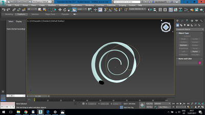

Hi. After my 3D max has updated in this year, my multiple shape loft stuff was very ugly do it ( screenshot i do it the shapes with lines and lofted. ). now i can't get the second shape to use in the same loft. is there a new procedure of steps to get the second or more shapes after the first shape loft? i want to loft an egg shape ( standard one from SPLINES ),than the ellipse shape than again the egg ....  and so one.  thank you.

Chance are that there is some XForm history in there.  I did a test (attached) and it seems to be working ok on my end.  I have used this tool a lot and one thing I've found is that the best way to fix the problem you're having is to select those shapes that are giving you problems, then right click on the move icon and right click on all the spinners to put the shapes in the center of your world.  Then Reset the Xforms on them at the same time, convert to edit spline, and try again.   This isn't a new issue though, it's just an old tool.
Another option is to go into the subobject mode for your middle shape and rotate it to fit a bit better.  You probably already know that though but figured I'd mention it.
If you still have problems, attach a sample max file please and I'll take a look and offer suggestions.  Thanks!

 Like this must to be. Screenshot (313).png This is 1 complete cycle and this one i must to multiply it in a string form.
          This is do it in FUSION 360 by a friend who try to help me with this speacial construction. Like this i succed before the update to do here. How you see in FUSION 360 we need a lot of shapes for interpolation. For this reason i'm trying with3DMax ,because i see is more quik and easi to work with this shapes like in Fusion.
