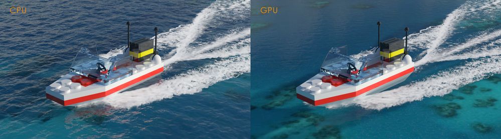

Hello!
I am using a multipass material with Glass to create the water and plastic to create the foam, everything works fine in CPU raytracing but the displacement disappears in GPU raytracing...
Any idea?
Thanks.
Joffrey
1 REPLY 1
Hi
displacements in multipass materials are not yet supported, it is still on our todo list.
Kind regards
Michael
