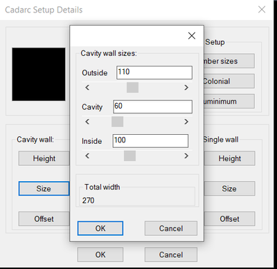

rkmcswain
        Are you talking about nested dialog boxes, like this?
Message 3 of 12
dvertz
I am afraid that nesting dialogs is not what I am looking to do. As I have too many pages and it would go beyond the 8 levels max. As I want to select a button and have the current dialog removed and open a new dialog at the same time. I understand how to nest dialogs and I understand how to hide dialogs for screen selection and then have the dialog come back. I am attempting to remove a nested dialog requiring extra buttons to initiate the next page in a series of dialogs. If the dialog was just hidden, to display the next dialog, then how would I get ride of it when all pages were done. (terminate maybe?) If the dialogs are just hidden does that impose the limit of 8 max?
