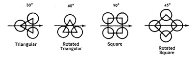

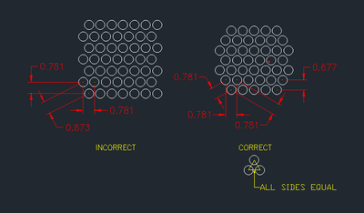

I am looking for a routine that will repeat a triangular pattern with equal distances between shapes (circles) at different angles. Array will not work, as it only gives the distance between rows and columns, NOT the distance between the objects. The pattern would then be repeated about a center point. (The square pattern below can be done with the default array command, obviously)

Kent1Cooper
@intern59T6U wrote:
.... Array will not work, as it only gives the distance between rows and columns, NOT the distance between the objects. ....
Do you mean the clear space between objects?  If they're always Circles, that's just the column/row spacing minus the Circle diameter.  If they're sometimes other shapes, that becomes a lot more questionable depending on the angle of the Array.
Were you aware that an ARRAY can do the angle for you?  It doesn't appear to be something you can specify within the command, for some reason, but once drawn, you can specify it in Properties:
That's not in your hexagonal arrangement, but maybe you can make use of it.

Sea-Haven
Message 6 of 9
intern59T6U
This one is close, but does not account for the XY spacing. It only works for the spacing between  X and Y (again, not the XY distance I am looking for. (I believe the second "copy" command  would need to be modified).

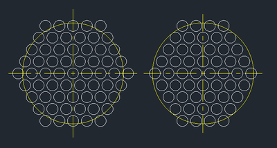

Example:

Sea-Haven
Its a case of Pythagoras you know the spacing is 0.781 so vertical is 0.781^2-(0.781 / 2)^2 =0.6763658403556 so can put that into my lisp. Just needs a couple of lines of code.
Message 8 of 9
Kent1Cooper
@Sea-Haven wrote:
Its a case of Pythagoras ....
Or, it can be done trigonometrically:
(setq VerticalSpacing (* (sin (/ pi 3)) HorizontalSpacing))
Kent Cooper, AIA
Message 9 of 9
Sea-Haven
Good idea bit easier to code.
