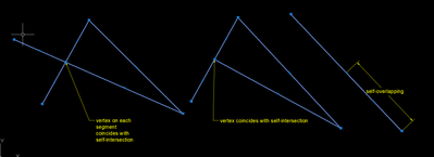

Message 63 of 124
АлексЮстасу
@marko_ribar,
Oh! 🙂
First, really fast.
Second, finds almost all self-intersections.
In mill_pl.dwg, false result on the smaller polyline, many or almost all vertices are considered self-intersections.
In start_test_100-100_mr.dwg, I've circled in yellow what's not found.
-- Alexander, private person, pacifist, english only with translator 🙂 --
Object-modeling _ odclass-odedit.com _ Help
Message 64 of 124

marko_ribar
@АлексЮстасу
I am sorry to bother you again, but it seems that my latest version fails to find intersection at example shown at picture...
So, to make it work in all situations, I am afraid that it must be much slower... Here is my latest code that passes this final test, but unfortunately it is very much slow... I don't know if Dan has something new, but like I said if striving for speed, then Python or ObjectARX, or .NET could be an answer... If you have BricsCAD, then maybe, this my code could be all that is needed...

Message 80 of 124
АлексЮстасу
@marko_ribar,
Yeah, it's working. But instead of two intersection points, it gives one. And it doesn't find overlaps.
Like the previous one, it checks for about 1 minute.
Why did you use Scale? And not Move?
Both this option and the previous ones for many cases of self-overlapping and touching do not give any messages.
I have attached an example with million coordinates earlier. I am attaching it here as well.
