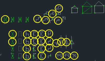

  (if (setq lw (car (entsel "\nPick LWPOLYLINE to find self-intersecting points...")))
    (if (= (cdr (assoc 0 (entget lw))) "LWPOLYLINE")
      (progn
        (initget 6)
        (setq mult (cond ( (getdist "\nPick or specify multiplication factor for circles size <1.0> : ") ) ( 1.0 )))
        (setq ti (car (_vl-times)))
        ;(vl-cmdf "_.scale" lw "" "_non" (list 0.0 0.0 0.0) 1e-6)
        (vl-cmdf "_.move" lw "" "_non" (setq sp (vlax-curve-getstartpoint lw)) "_non" (list 0.0 0.0 0.0))
        (setq selfs (selfinters lw sp mult))
        (vl-cmdf "_.move" lw "" "_non" (list 0.0 0.0 0.0) "_non" sp)
        ;(vl-cmdf "_.scale" lw "" "_non" (list 0.0 0.0 0.0) 1e+6)
        (prompt "\nElapsed time : ") (princ (rtos (- (car (_vl-times)) ti) 2 16)) (prompt " milliseconds...")
      (prompt "\nPicked wrong entity type... Picked entity must be LWPOLYLINE... Better luck next time...")
    (prompt "\nMissed... Better luck next time...")
  (*error* nil selfs sp)

Message 103 of 124
АлексЮстасу
@marko_ribar,
I didn't make it in 1 second:
Команда: SELFINTERS
Elapsed time : 318047 milliseconds...
Команда: SELFINTERS
Elapsed time : 208078 milliseconds...
((7653912.613957368 6229064.962335566) (7653912.613957532 6229064.962335717))
Команда: SELFINTERS
Elapsed time : 169422 milliseconds...
((7653288.087277066 6229052.952317797) (7653288.08727723 6229052.952317947) (7652990.315149783 6229574.36978839) (7652990.079111385 6229574.941561909))
-- Alexander, private person, pacifist, english only with translator 🙂 --
Object-modeling _ odclass-odedit.com _ Help

АлексЮстасу
@john.uhden,
The yellow circles are what's not found:
Nothing found in million coordinates.
But with “houses” it's found.
