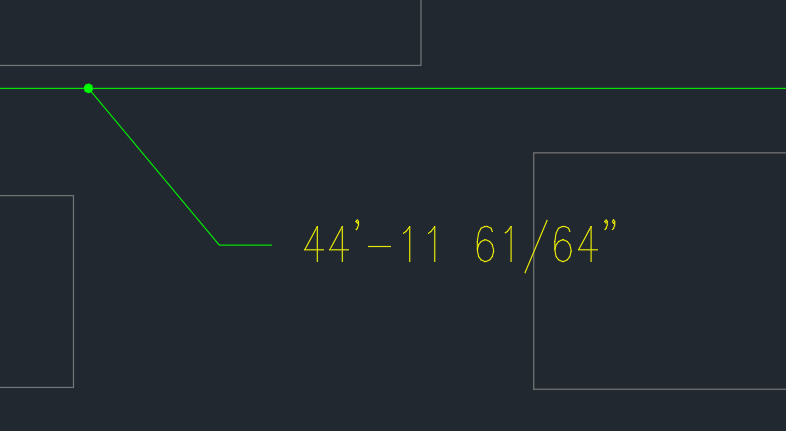

is there a lisp or program where i can click on a polyline and show the length of that line on the end of a leader that i can move around and drop off

here is a screen shot.
i apploaded the file. typed test. and then i get this

What you need to change is the command name you're using.  TEST is the command name from the other routine from @Satish_Rajdev.  The command name in mine is LTLL [always the part that immediately follows (defun C:  in the command-defining code].

omg success!!!!!!!!!! its not selecting the 90 degree bends where i camfered. but everything else is perfect!

the last thing is being able to select the filleted bends and add that into the total measurement if that is possible. and if the text can come at the end of the leader instead of being positioned above the leader. if you can do that you are my hero.

I'm not sure what you mean about the bends.  In Message 23 you said they were c[h]amfered, but here you say filleted.  If Chamfered, are they not also Lines like the rest, that you can select along with the rest?  If filleted, Arcs would need to be added to the selection filter, and a different method would be needed to get their length [Arcs don't have a 'Length VLA Property as Lines do] -- not difficult, but I'll wait to hear whether Arcs are involved.
Where the text lies in relation to the Leader line element is a function of the DimStyle of the Leader -- modify that to place the text where you want it [or make a separate Style for these, if you don't want to affect Dimensions that use that Style].

attached is a screenshot while in the middle of the command where you can see that straight lines are selected but the fillet (bends) can not be selected and added into the overall total length

So, Filleted rather than Chamfered.  Try the attached [note that I added a letter to both the file name and the command name ].
BUT if these are always contiguous-at-their-ends series of Lines and Arcs [or all Lines if Chamfered], I would strongly recommend that you make them as Polylines  instead of all those separate pieces!  It would use less memory.  You can do line segments for the "base" route [or, if you have Lines already, join them together into a Polyline with either JOIN or PEDIT's Join option], and then you can Fillet or Chamfer all the bends at once, using the Polyline option in either command.  Not to mention that it would involve selection of only one  object in a routine to do this labeling, and the determination of its length would be direct and immediate, not by a calculation involving stepping through separate objects and adding up their lengths.

how do i get the text to dome at the end of the leader line instead of on top of it?
Message 30 of 39
to come at the end of the line.... not dome
i want the text centered with a small gap at the end of the leader line. currently it comes above the leader line.

DIMSTYLE command [just plain D is the default alias for it]; pick the applicable Style name; Modify...; Text tab; Text placement area.

ok man thats perfect. its exactly what i wanted and exactly what i needed. you did a great job. thank you for your time. i am 100% happy and satisfied.

2 things I was wondering if we could tweak this lisp slightly.
1. we are really cramped for space, is it possible to use a spline type leader with multiple points so that we can navigate around items on our sheet before we drop off the text. something like after we choose the conduit to measure and hit enter, then we left click on the line to start the leader & we draw the spline with multiple points then hit enter to drop off the text.
2. can we round up the measurement up to the next foot if there are inches (ex 1'-1 1/2" = 2' or 5'-7" = 6'). As stated before we are really cramped for space and getting rid of the inches would save a lot of space on the drawings in cramped areas.

The attached is close.  The one drawback is that after the second point designation in the Leader, you don't see it forming  as you pick points, until you end it, then it's drawn in and the text goes in.  I'm not sure whether there's a way to get around that, but if I think of anything, I'll be back.  I suggest [if you don't already as I do] turning on .BLIPMODE so you can see what points you've picked so far, and you can route it around stuff with a good idea of where it's going.  That could be built in, if you like, and turned off at the end if you don't normally use Blips.  [I always have them on -- I find they provide very useful information -- but a lot of people hate them, or don't even know about them.]
