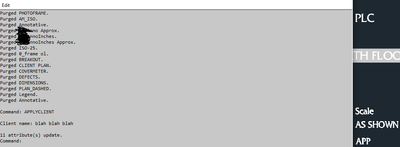

h_s_walker
Ok so we will do drawings, sometimes with many pages.
In our title block with have an attribute for the name of the client.
Originally it is blank, but quite often the project leader does not give us the client name until late in the game when we've done many layout tabs.
Now you can understand going into each layout just to put in the client name is a PITA.
So is there a gatte equivalent I can use for LT2025

cadffm
@h_s_walker  schrieb:
 The PLC you can see in the image below
I can see the image,
but I can't check blocks, blockreferences and Attributes.
PLEASE share this title part (orignial drawing, delete all other stuff).
I think that's fair, lots of helpers, lots of work, then we should at least be able to resolve the problem.
Sebastian

cadffm
And I ask about a sample file where applyclient doesn't work ( the .dwg you screenshot)

komondormrex
@h_s_walker
check updated code i posted earlier. it will strcase tag input not when typing but when typing is done. hth.

h_s_walker
@komondormrex Perfect. Thanks

cadffm
@cadffm Here is a sanitised drawing with all the relevant information removed which will not change the client name
and you tested this file before upload?
cadffm: If test1. faild, do the same as before
              Delete all problematic entries, save the file under a different name.
              Close the file, open this file, load applyclient and run it.
              Is the problem still there? Then share this DWG.
If so, sorry. The code works very well in LT2025.1.1, what I installed specially for you and your files.
"2 attribute(s) update."
Attachment is 100% the same code as above (13349036#13346232)
Sebastian
Message 50 of 53
h_s_walker
@cadffm I don't know what's changed, but that's working now.
I shall use both yours and komondormrex lisps

Then everything is fine,
I assume that the problems were not due to the program itself.
I just want to make it clear that the Lisp is by @Moshe-A , not really mine.
h_s_walker,  If you like, there are additional messages integrated here, so you are made aware of locked layers or other problems <click>
Command: APPLYCLIENT
Client name: fff
1 update failed (Block: ATTRIBA1a | Att-Layer: 0_UK | Tab: A1_5522-2)
2 attributes updated, 1 failed
Command:
Sebastian
